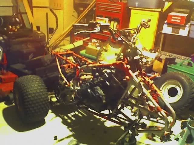

I figured out what is keeping it from going into reverse.
Here is some pics this morning after taring it all down last night
Here is the cause of it not going into reverse
jwrape is offline

Damned bolt!
